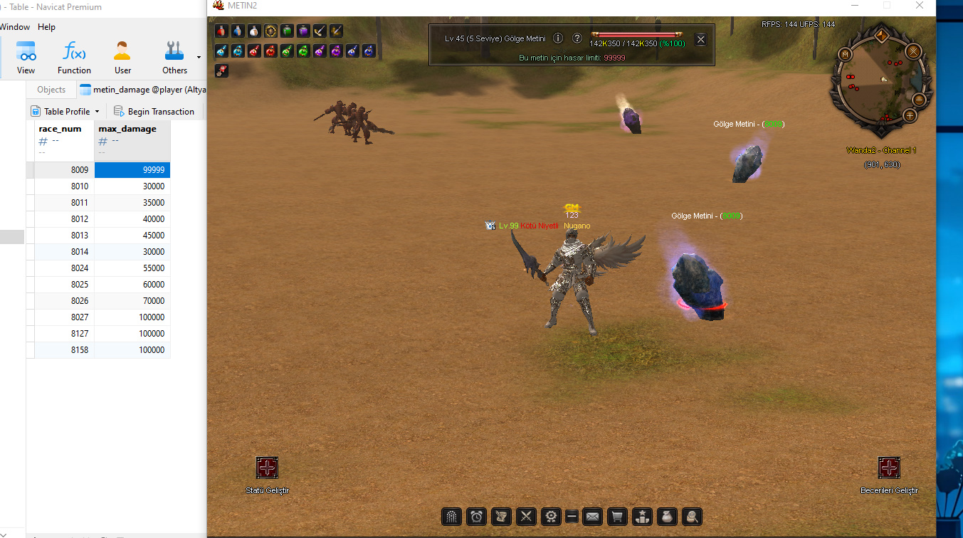

This system allows server administrators to define a maximum damage threshold for specific Metin stones or special monsters. Once configured, players will not be able to exceed the specified damage value against these targets, ensuring better game balance and preventing rapid destruction of objectives.
### Technical Overview
  • Server-Side: Implements the actual damage cap logic within the battle mechanics.
  • Client-Side: Displays the damage limit information directly in the target window when a player selects a Metin stone.
  • Configuration: Limits are defined per mob VNUM. While this version uses hardcoded maps, the configuration can be updated via SQL and refreshed in-game using the /reload p or /reload m commands depending on your implementation.

### Summary Note
The server-side code ensures that players cannot bypass the restriction, while the client-side changes provide a clear visual indicator in the Target UI, telling the player exactly what the damage ceiling is for the current Metin stone.
