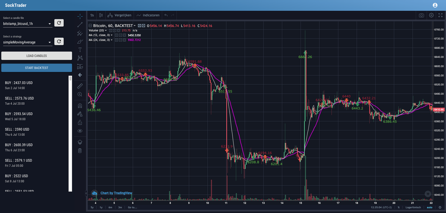

We've created an online dashboard that allows you to visually confirm all trades made during a backtesting session. It features a live reload functionality, meaning SockTrader will restart the current backtest whenever you modify and save your strategy code. All executed trades will be displayed on the chart, as illustrated in the provided screenshot.
To try it out yourself:
  1. Follow our Quick Start guide.
  2. Execute npm run web and keep all settings at default.
  3. Visit our online dashboard to test your strategies!
