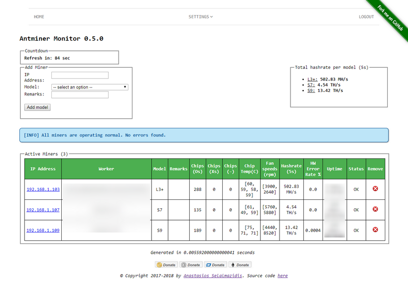

This application allows you to manage multiple miners conveniently and efficiently.
  • Add as many miners as you desire.
  • Supported Miners: A3, B3, D3, E3, L3, L3+, L3++, R4, S7, S9, S11, S17, S17 Pro, S17+, T9, T9+, T17, V9, X3, Z9 mini, Z11
  • Monitor Performance Metrics: Check hashrate, temperature readings, fan speed, chip conditions, hardware error rate, and uptime.
  • In-App Notifications: Receive alerts for miner errors (requires page refresh).
  • Error Logging: Keeps a log of errors in a file for future reference.
  • Hashrate Summary: Displays total hashrate organized by model.
  • Secure Access: Login page protected by a password.
Screenshot
