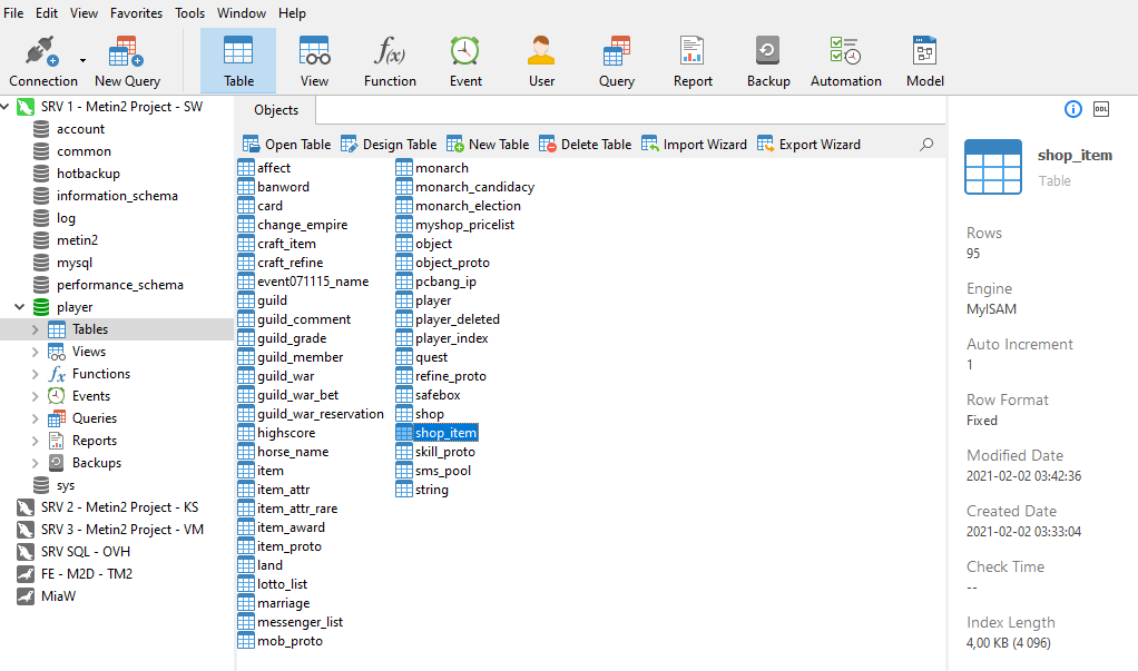

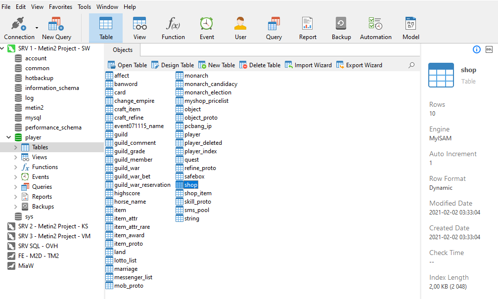

Step 1: Open the Shop Table
  1. Begin by launching Navicat, then navigate to the player database and open the shop table.

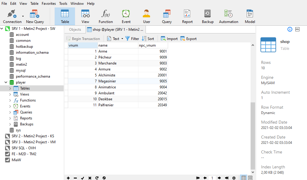

Step 2: Understanding the Shop Table Structure
  1. The shop table should appear as follows:
You’ll find the following columns in the table:
  • vnum: The unique identifier you’ll assign to your shop.
  • name: This is for your own reference and does not appear anywhere, so label it whatever helps you.
  • npc_vnum: This is the vnum for the NPC linked to your shop, which can be found in the mob_names.txt file on your server.
Great! You can now add a new entry by clicking the "+" button at the bottom of Navicat. Don’t forget to save your changes once you’re done!

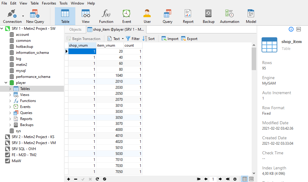

Step 3: Assign Items to Your Shop
  1. With your shop created, it’s time to add the items you wish to sell. Open the shop_item table located in the player database.
The columns you’ll find in this table include:
  • shop_vnum: This corresponds to the vnum of your shop.
  • item_vnum: Corresponds to the unique vnum of the item you want to add, which can also be found in item_names.txt.
  • count: Indicates the number of items you wish to offer for sale (make sure these items can stack).

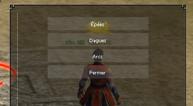

Step 3: Example of Multi Shop Assignment
  1. For instance, if you want to assign an NPC several weapon shops, your quest might look like this:
