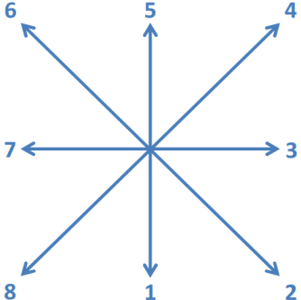

3. Direction
The dir parameter sets how your NPC will face upon spawning, ensuring they’re oriented correctly. This helps avoid situations where NPCs may turn their backs to players.
Supported directional values:
  1. South
  2. South-East
  3. East
  4. North-East
  5. North
  6. North-West
  7. West
  8. Southwest
  9. Random direction
Reference Image for Orientation
Direction Guide

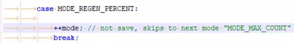

5. Spawn Probability
The percent parameter is currently not utilized in the game logic. As indicated in the regen source files, it gets skipped to the next token, MODE_MAX_COUNT. For uniformity, simply use the value 100.
Reference Image for Probability
Probability Image

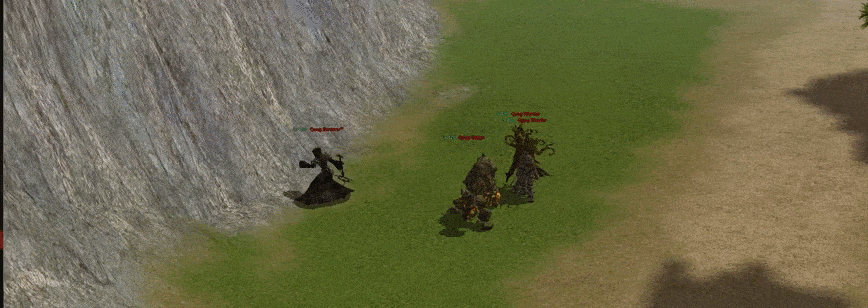

6. Spawn Amount
The count parameter dictates how many monsters or NPCs will spawn at specified coordinates.
Warning: All monsters will appear at the same position, regardless of any random coordinate generation.

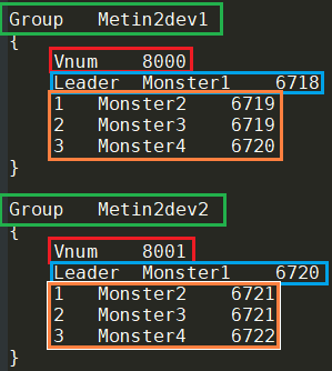

1. group.txt
With this file, you can create a specific and non-random group, structured as follows:
Group Structure
  • Green: Name of the group (feel free to choose any name).
  • Red: Unique VNUM for the group.
  • Blue: Mob leader and its VNUM.
  • Orange: The ID for your mobs within the group, including their names and VNUMs.
