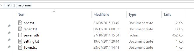

  2. Add Your Map Folder:
    Inside this location, you'll need to create a new folder for your specific map. Ensure you include the following three essential files in this folder:
    • Setting.txt: Contains all important information about your map, including coordinates.
    • server_attr: Includes the attributes related to your map, such as fishing spots and walkable areas.
    • Town.txt: Specifies the respawn coordinates for your map.
    Here’s a glimpse of how my folder looks:
    Map Folder Example

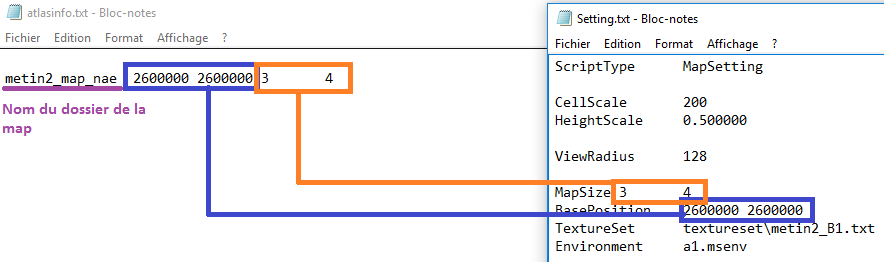

  2. Unpack and Edit atlasinfo.txt:
    Unpack the root file to access the atlasinfo.txt file, where each line follows this format:
  • Name_Folder_Of_Your_Map    COORDINATE_X    COORDINATE_Y    WIDTH_MAP    LENGTH_MAP
    Note: You can find these details in your map’s Setting.txt file.
  • Add Entry to atlasinfo:
    In my case, I included the following line in my atlasinfo file:
  • metin2_map_nae 2600000 2600000 3 4
    AtlasInfo Example
    Warning! If you can’t find your atlasinfo, double-check step 2 but make sure to look in the atlasinfo.txt located in your client’s local pack (locale/XX/atlasinfo.txt).
