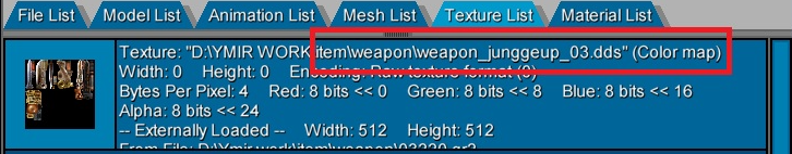

  4. View Your .gr2 File:
    Open your .gr2 file using Granny Viewer. In the TextureList tab, you will find the path to your item's texture.
    Granny Viewer Example
    Make sure to place your texture file exactly at the specified location, using the same name. For instance, in the provided screenshot, the texture should go into the weapon folder.
