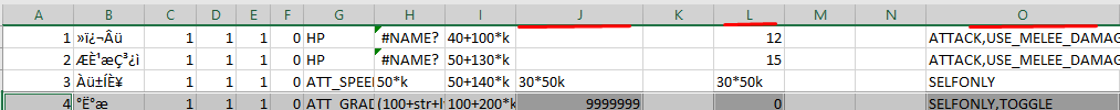

Modifying skill_proto
You will start by selecting the VNUM of the skill you want to modify. Make the following adjustments in the specified columns:
  • szDurationPoly: Change from 30+50*k to 9999999
  • szCooldownPoly: Change from 30+50*k to 0
  • setFlag: Update from SELFONLY to SELFONLY,TOGGLE
Example:
Example Skill Proto Modification

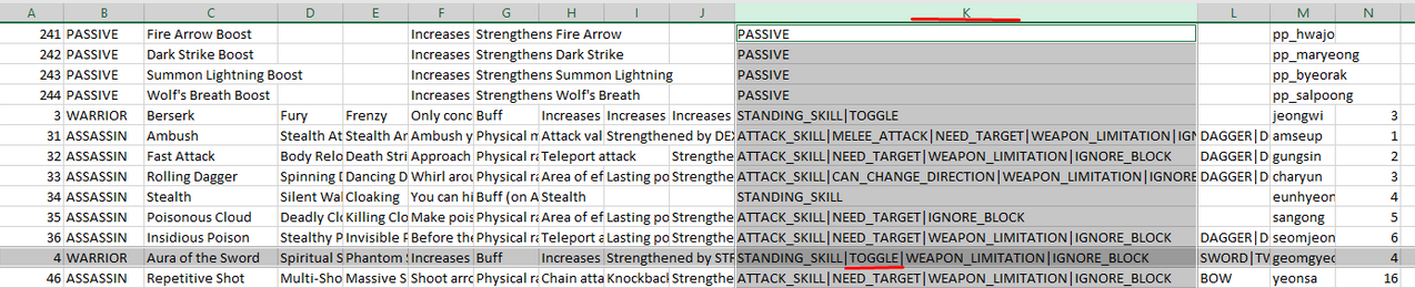

Updating skilldesc.txt
In the skilldesc.txt file, it’s essential to add "TOGGLE" after "STANDING_SKILL."
Don’t forget to include the vertical bar (|) to ensure proper format.
Example:
Example Skill Description Update

In this file, repeat the modifications applied in the skill_proto:
  • Change 30+50*k to 9999999
  • Change 30+50*k to 0
  • Update SELFONLY to SELFONLY,TOGGLE
Example:
Example Skill Table Update
