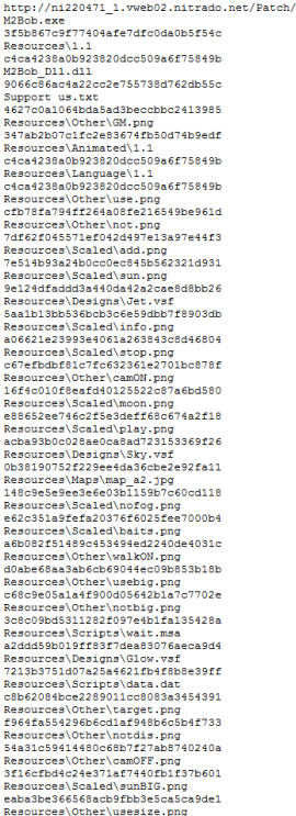

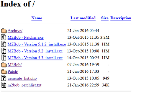

When you first launch M2Bob, this is the executable that runs. It generates a 128-bit digest (likely an MD5 hash) for each file to be scanned on the disk and sends this data via a POST request to an API that compares the client files against the latest server files. If there are discrepancies, it promptly downloads and replaces the outdated files using the HTTP protocol.
The patcher connects to a web server located at the subdomain ni220471_1.vweb02.nitrado.net. As you'll infer, there’s little doubt about the contents hosted there.
