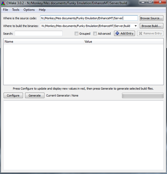

Now, open CMake and specify the path to your source code (select the Server folder) and set the "Where to build the binaries" to the "Server/build" folder:
CMake Configuration

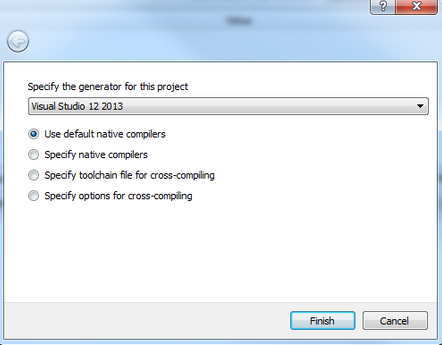

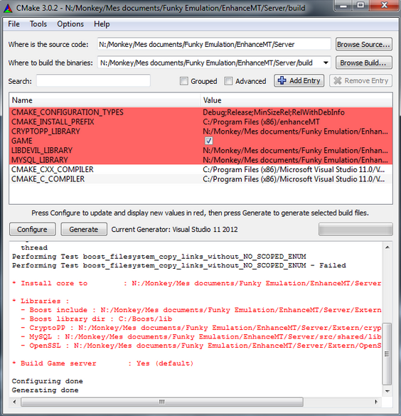

Click on "Configure" and select your compiler (Visual Studio (Express) 2013), then click "Finish":
CMake Finish
Finally, click "Generate" to build the solution and ensure that there are no compilation errors:
CMake Generate

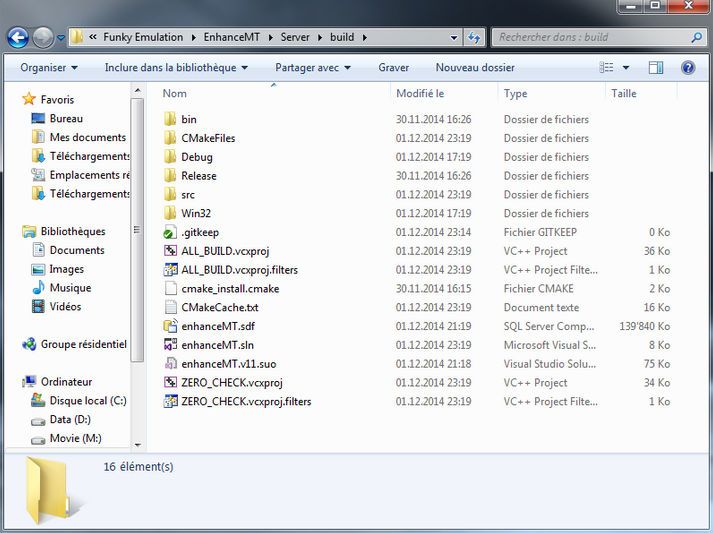

You will find the Visual Studio solution file in the "Server/build" directory. Open "enhanceMT.sln" using Visual Studio (Express) 2013:
Visual Studio Solution
In the menu, select "Release" mode and navigate to "Build -> Build Solution" (or simply press F7).
Once the build process completes, you'll find the "db.exe" and "game.exe" executables in the "Server/build/bin/Release" folder.
