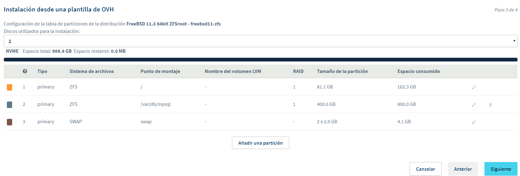

Before configuring the operating system, ensure that you've rented a server and created necessary partitions. In my setup, I opted for a server with 64 GB of RAM and two NVMe disks. Notably, NVMe disks outperform traditional SSDs in speed. My hosting provider, a well-known French company, offered a single BSD option—a preconfigured template with FreeBSD 11.3 ZFS, which I selected. I chose English and customized my partitions.
During partition setup, I allocated a separate partition for MySQL at /var/db/mysql, using about three-quarters of the available space (400 GB), reserving the remainder for other uses. Additionally, I created a 2GB swap partition. Keep in mind that due to the RAID configuration, the displayed partition sizes will appear doubled.
RAID Explanation
In layman's terms, a RAID setup consists of multiple hard drives that contain identical data and operate together. This redundancy ensures that if one drive fails, the server continues to function, mitigating data loss and downtime. However, it's worth noting that additional drives do not provide extra storage capacity, a trade-off that is justifiable for critical applications.
If you're uncertain about the space required for MySQL, a single large partition (Mountpoint "/") can suffice, and you can eliminate the default "/home" partition, which typically holds minimal value. Utilize the arrow icon during the partition finalization to ensure all available space is utilized!
