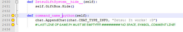

Next, define the function in Python named command_name_python or the name you used:
Make sure all functions and text are properly aligned with TAB key spaces.

Finally, implement these functions in game.py:
Ensure that the last line of your Python files is left blank.
