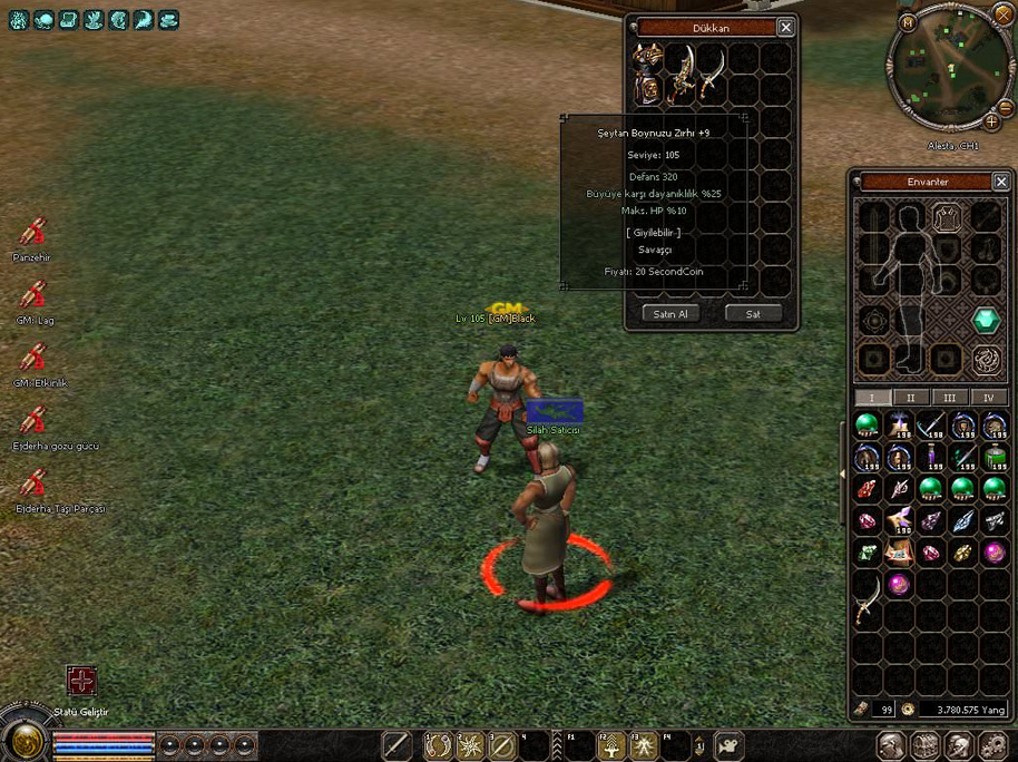

Final Result
After completing these steps, your configuration should yield a visual result similar to what's shown in the image below:
Shop Ex Result
