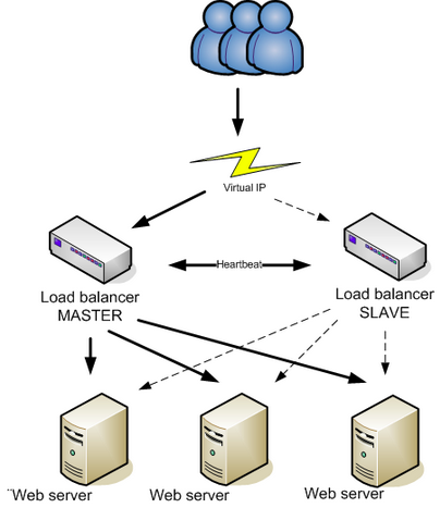

Active-Active Cluster
This diagram illustrates how to establish an Active-Active balanced cluster for web hosting, patch servers, and MySQL servers with multi-master replication.
To implement this, you will need at least two machines for your MySQL, web host, and patch server, along with two load balancers (or a more affordable DNS balancer), and a failover IP or DNS.
With this configuration, clients or applications will connect to your active load balancer (designated by a failover IP or domain name), which distributes traffic across each node in the cluster. This setup has dual benefits: it enhances both performance and availability. When a node needs to be taken offline, or if problems arise, another node is prepared to take over without any service interruption. When all nodes are operational, you can utilize the combined power of each node simultaneously.

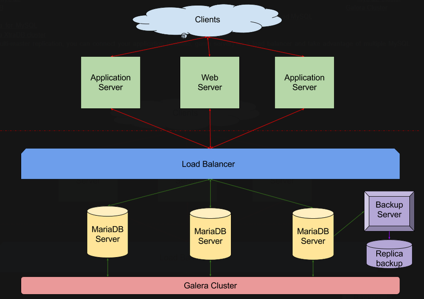

  • MariaDB: A fork of MySQL developed by the original MySQL developers prior to Oracle’s acquisition. Its clustering software is called Galera Cluster, which is installed by default starting from MariaDB 10.1. For installation guidance, see this
  • Percona for MySQL: An enhanced MySQL alternative designed for better performance, utilizing XtraDB instead of the older InnoDB storage engine. Its clustering solution is known as Percona XtraDB Cluster.
With these multi-master replication setups, your applications (like your website and game server) can connect through a load balancer, benefiting from multiple MySQL servers.

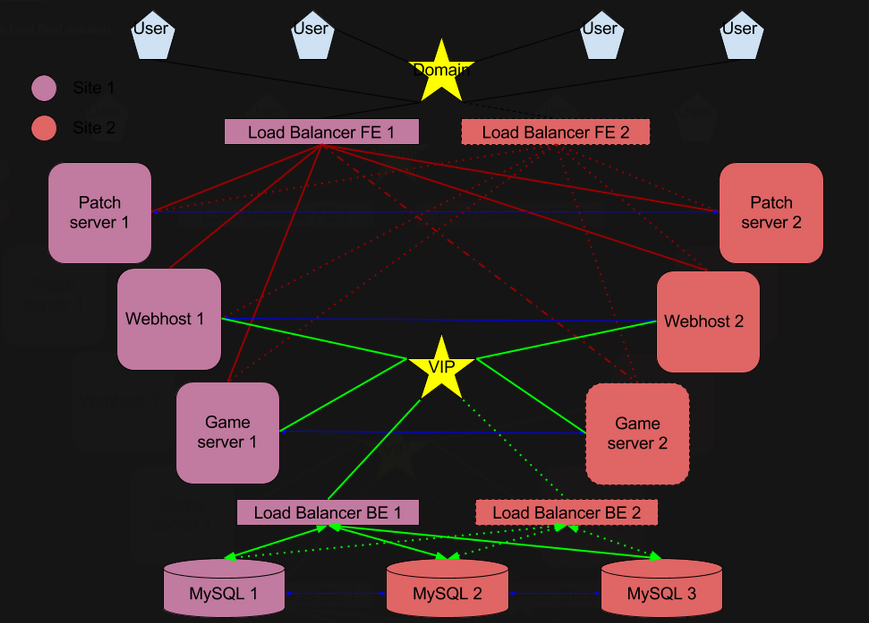

This is an example of a final solution:
Final Solution Example
Remember, this is just a starting point; feel free to adapt it based on your skills, resources, and budget. You may opt for different VPS and load balancer options or acquire two (or more) dedicated servers with a hypervisor to create multiple VMs.
To ensure optimal availability, it’s ideal to place Site 1 in a different data center than Site 2, ideally in another city if possible.
