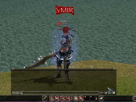

Enhancing the user interface of chat systems in games can significantly improve overall player experience. This guide covers how to add a feature that allows for clearing the chat in a C++ game application.

By following these steps, you will have successfully integrated a clear chat feature into your game, enhancing the communication experience for users. Make sure to test the modification thoroughly to ensure everything functions as intended.
