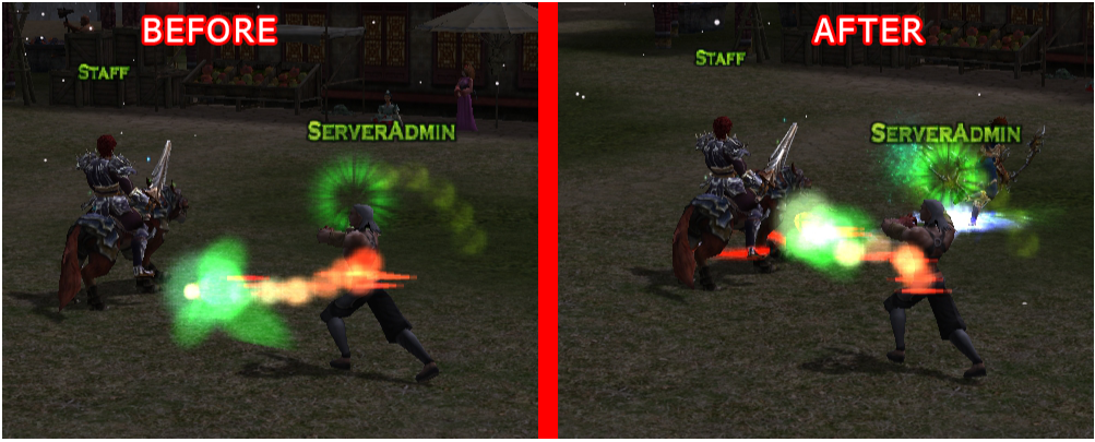

Enhancing the gameplay experience for ranged attackers can greatly impact tactical strategies in your game. This guide focuses on modifying the target positioning code to account for whether the character is mounted on a horse or not.

  • Removal of Redundant Code: The original code had unnecessary checks for setting the center vector, which has been streamlined.
  • Height Adjustment for Mounted Characters: The addition of the conditional block if (__IsMountingHorse()) ensures that if the character is on a horse, the Z-coordinate of the target position is increased by 110.0f. This change elevates the target's height appropriately, improving accuracy for ranged attacks.
By incorporating these adjustments, you ensure that the game accurately reflects the mechanics of mounted characters when they engage in ranged attacks. This modification not only improves gameplay dynamics but also enhances the strategic elements of using mounts in your game.
