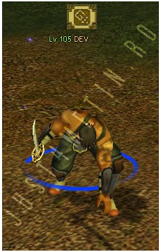

By following these steps, you will have successfully implemented an animation for item pickups in your game, enhancing the gameplay experience significantly. Here’s a preview of the result that you can expect from this modification!
