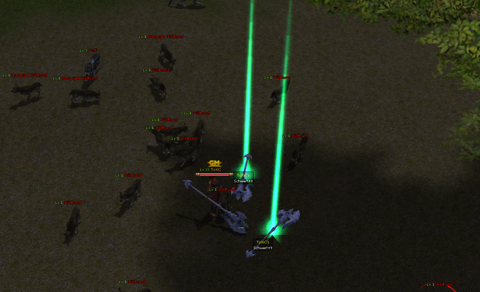

Enhance your game by adding tailored visual effects to items when they appear on the ground. This approach allows you to assign distinct effects based on item attributes, creating a more immersive experience.
Overview
This guide demonstrates how to implement a system where dropped items can have different effects, such as glows or animations, depending on their rarity or type. You can filter items by their unique identifiers (vnum), category, and subtype, then assign corresponding effects. For example, rare items might emit a shimmering glow, while legendary items could have a distinct starry border.

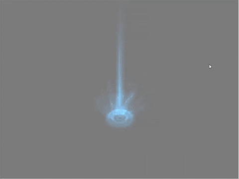

Step 4: Initializing Effect Files
Now, you need to specify which effect files correspond to each category.
1. Locate the Create method:
2. Replace its entire content with:
Note: Ensure that these effect files exist in your project directory, or create custom effects as needed.
