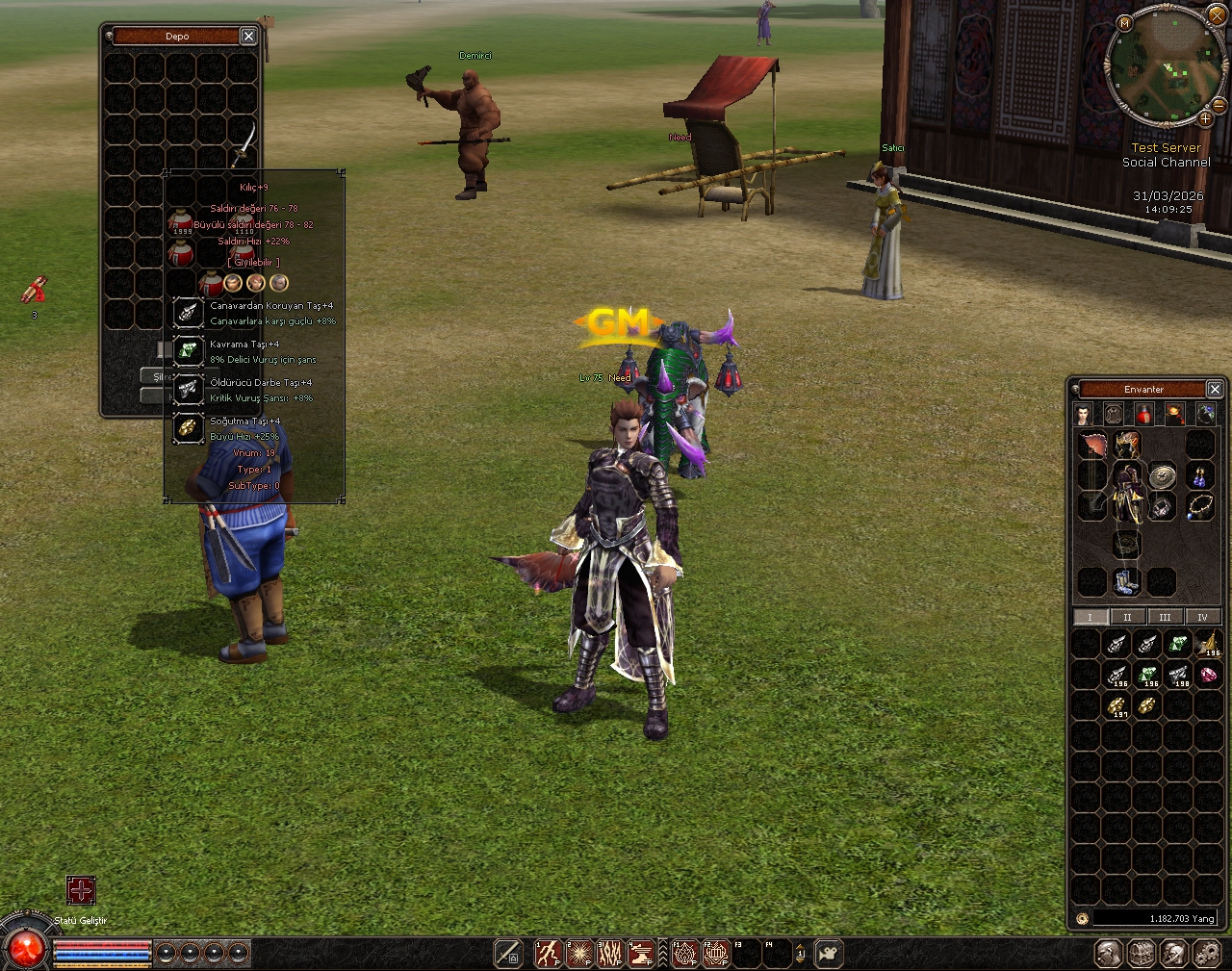

How to Add 4th Socket (Stone Slot) to Items + Bug Fixes (Server & Client)
301403_1a83e87e814eb7bf3c1d796e92bd86df.
As most server administrators know, the default limit of 3 socket slots on Metin2 PvP servers can create major balancing issues. When players maximize their gear with Warrior, Sura, and Ninja resistance or against-stones, they are often left completely defenseless against Shamans.
To restore class balance and create a fairer PvP environment, this guide will show you how to expand your item system to support 4 Sockets. We will go through the process step-by-step, covering Server Source, DB Source, Client Source, and essential bug fixes.

💾 Section 3: Database Update (MySQL)
⚠️ CRITICAL WARNING: Even though your source code is ready, items will not accept a 4th stone until your database structure is modified. You must update your item_proto via Navicat / MySQL. Do not change the client-side locale item_proto manually for this step, or you risk breaking item glows!
Run the following SQL query to automatically shift all 3-socket items to 4 sockets:
SQL
UPDATE item_proto SET socket_pct=4 WHERE socket_pct=3;

📌 Fix A: The Warehouse / Storeroom Bug
Description: Storing an item with 4 stones inside the warehouse causes the 4th stone to disappear or resets the item slots back to 3 upon item retrieval.
